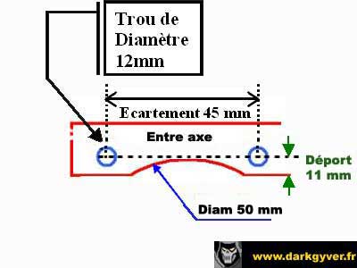

SLT
TENEZ UN PETIT PLUS SA AIDE
Image[/URL]
